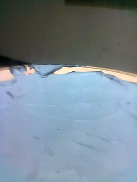

I made FeCl2 solution. In another container i dissolved some BAP(biammonium phosphate, that i bought frm fertilizer store) in water and filtered it.
When i added FeCl2 to BAP , i instantly saw white ppt. I believ that it was FePO4. I allowed that to settle down.
After a few hours, i saw that the precipitate now looks bluish. I filtered that and allowed to dry. Now some parts of the ppt look even darker blue. I'm going to upload a photo of it.
Now my question is, Wth have i made ?

Photo, with my low quality camera

An orthophosphate with a Fe(II) salt could never yield Fe(III)PO4, without prior oxidation of the ferrous ions to ferric ions.
Fertiliser diammonium phosphate is likely to seriously contaminated.
Fe3(PO4)2 does appear to exist though and is reported as insoluble.
[Edited on 15-3-2013 by blogfast25]

Perhaps "Ferrous ammonium phosphate" ?
Pure dry FeNH4PO4 is a greyish-green powder. See http://www.fao.org/ag/agn/jecfa-additives/specs/monograph7/a...
One route to preparation:
"Ferrous ammonium phosphate is manufactured by first combining
iron powder and phosphoric acid in deionized water with stirring
and heating the mixture to get ferrous hydrogen phosphate as a
slurry. Ammonia is added to get ferrous ammonium phosphate."
[EDIT] Your possible reaction:
(NH4)2HPO4 + FeCl2 --> FeNH4PO4 (s) + NH4Cl + HCl
and the presence of HCl limits the hydrolysis of the FeCl2:
FeCl2 + 2 H20 <---> Fe(OH)2 + 2 HCl
[Edited on 15-3-2013 by AJKOER]

Not very likely, IMHO. The dissociation of diammonium phosphate:
(NH4)2HPO4(s) === > NH4(+)(aq) + HPO4(2-)(aq)
The trouble is that there really isn’t anything in there that can the deprotonate HPO4(2-), except for insolubility of FeNH4PO4.

The trouble is that there really isn’t anything in there that can deprotonate HPO4(2-)
If FeNH4PO4 is sufficiently insoluble, then
Fe2+ + NH4+ + 2 HPO42- --> FeNH4PO4(s) + H2PO4-
will be favourable.
Anyone know the Ksp of FeNH4PO4?
If we use K2 = 7e-8 and K3 = 4e-13 for phosphoric acid, then the disproportionation reaction would have a Keq of 5.7e-6. So if the Ksp for FeNH4PO4 is 6e-6 or less (and most Ksp values are), then this reaction will have a Keq of greater than one.

That means my BAP is contaminted and i made an iron complex. But what kind of iron complex could have bluish color ?

I would assume that your wet precipitate is oxidizing, and you're getting a mixed iron oxide/phosphate.
