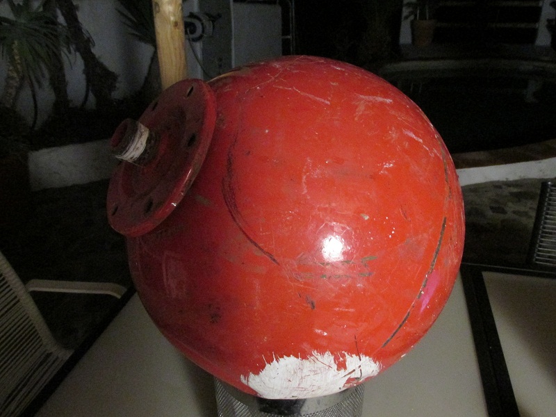

Swapped a dead car battery for this yesterday at the scrapyard.
13" diameter, Hand/arm sized hole in one end, machined water-tight seal, end-plate with a 1" fitting, other end has a bicycle-type valve, easily replaced with a nut n bolt.
All Steel.
Wooohooo !
Watch out PVC, here we go ... Pyro To The Max (tm)
shere1.JPG - 158kBsphere2.JPG - 159kB
[*] posted on 8-11-2014 at 10:24
I'm pretty sure these are parts of a typical Citroen DS air suspension system. Also used on Bentleys.
Spherical is always good.
You might want to lubricate the manifold thread a bit so it will open more easily after firing.
[*] posted on 8-11-2014 at 11:06
PTFE seals better, and won't go liquid & run out under the high heat.
Lithium grease is supposed to be good for high temperatures (no idea how high).
Combining a spanner with the high-mass inertial adjustment tool always works, sometimes with the help of a blowtorch, and large volumes of swearing.
Edit:
I think the sphere is a pressure absorbing/equalising thing for a pool or other closed water system, that prevents 'knocking' due to resonances or pressure pulses. It had a rubber bag inside it, which i should have pyrolised instead of chucking.
[Edited on 8-11-2014 by aga]
[*] posted on 8-11-2014 at 13:15
PTFE MP is about 600 K. But probably better than oil anyway.
[Edited on 8-11-2014 by blogfast25]
[*] posted on 8-11-2014 at 13:29
I was about to say 'oh bugger', but if the PTFE does melt, then it'll be an easy indication of temperature reached.
Hmm.
That'll only be half way to the target temperature ...
Smear Al2O3 paste onto the threads maybe ?
[*] posted on 8-11-2014 at 13:50
No, wait: graphite!

[*] posted on 8-11-2014 at 14:17
fire cement or asbestos is generally used in industry for such purposes.

[*] posted on 8-11-2014 at 14:41
Ah I think you mean what they call a Scottish screwdriver ;).
Looks like it should do the job!! Just think what you could have got with a live battery lol
[*] posted on 8-11-2014 at 15:13
I got no asbestos or fireclay/cement, and my pencil has no lead (joy of vasectomy).
PTFE, Bentonite Clay(cat litter), Al Oxide and Mud i have.
It may be that if the joints are tight enough that they won't leak much anyway.
One easy way to find out what works best ...
Fire ! (maybe airflow assisted)

[*] posted on 8-11-2014 at 15:16
sodium silicate can be used too.
[*] posted on 8-11-2014 at 15:18
Cool ! I got some of that. Cheers.
[*] posted on 9-11-2014 at 06:48
I wasn't really suggesting to improve leak tightness, only to make opening the sphere after firing easier.
Lubricating graphite and fire cement you should be able to get from a decent hardware store. Fire cement from a domestic boiler expert.
[Edited on 9-11-2014 by blogfast25]

[*] posted on 10-11-2014 at 03:40
The other place Aga you can get fire cement is a car replace place,no idea if spain has something like halfords but the stuff they put around exhaust manifolds is fire cement (ok you knew that). I just used some on my little kabota
