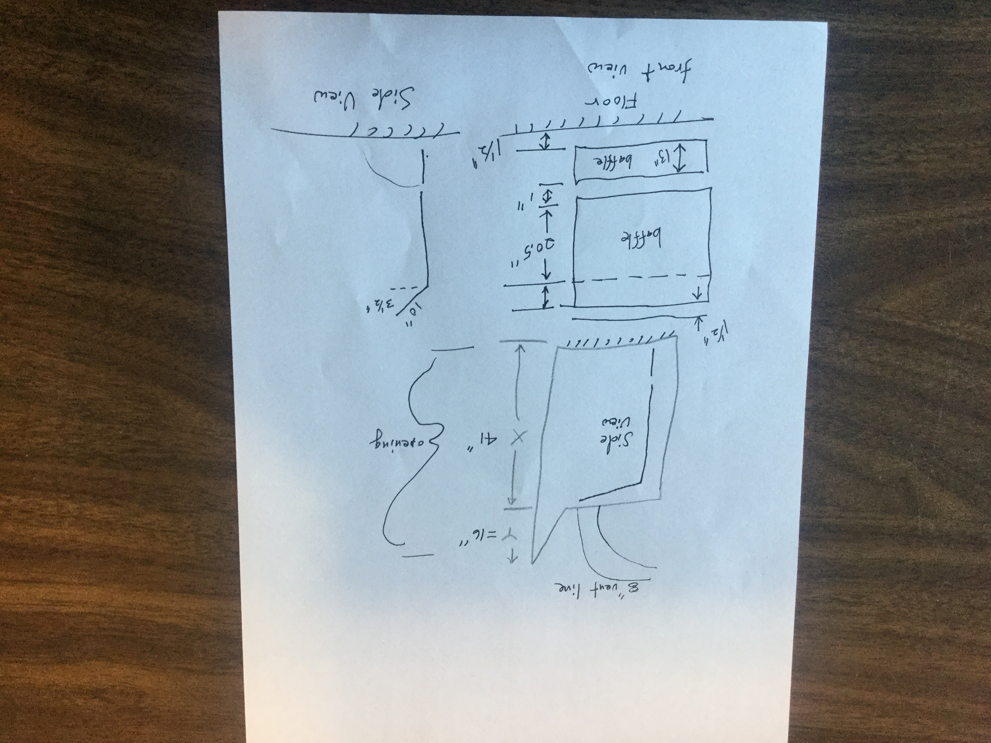

Here's 3 pictures of my homemade fume hood. These have been resized to a maximum dimension of 550 pixels so hopefully Taaie can put away his Dramamine. (Thanks Taaie for the software guidance ;)).
The hood dimensions are 41.5" H x 48"W x 28" D. (1" = 2.54cm). It is made from 14 gauge aluminum (1/16"). Inside is epoxy coated, except for the removable baffles (2 ea). There is a removable stainless steel pan with 1" high sides.
The blower is 120VAC, 1/4HP, 1000 rpm, squirrel cage, open one-end estimated to move 400-500 ft3/min. The ducting is 8" IPS 63 psi irrigation :D PVC with schedule 40 fittings.
The outlet plenum is 16 gauge stainless steel. Both sheet metal pieces were fabricated by local shops to my drawings.

Sorry to dig up this old post but I will need to operate the fume hood I built some years ago according to the dimensions you posted, right now it's a plywood box and baffles coated with 2-3 coats of epoxy, the only thing that is missing is the sliding window. According to what you posted the dimensions are as follows
box face dimensions
4' x 5' = 122 x 152 cm
window dimensions
48" x 41.5"= 122 x 105 cm
so there is a 47 cm bypass at the top or am I mistaken somewhere? Thanks.
[*] posted on 18-10-2018 at 13:35
Yes, you are correct. The bypass opening is necessary to provide a path for airflow. If you were to completely close off the opening the noxious vapors would just sit there.
Yes I understand that, I am wondering if 47cm is a bit excessive as a bypass, I've used fume hoods in my uni lab and the bypass from what I remember must have been not more than 30 cm and there was a grill in front. Is 47 cm the bypass you've used for your fume hood magpie? Thanks.

That's 60 cm of open space, so you have an area of 122 x 60 cm as open space(I mean the bypass) when the sliding window is closed, is that right? Have you put any grills in front? I haven't found any photos with the whole front face of your fume hood. I can literally fit myself through this bypass. :D The commercial fume hoods have an extra box in front of the window at the top where the bypass is,
I've noticed that in one of your photos you show a plenum behind the sliding window at the top, is the fume hood you built a box or does it have another shape? Thanks.
[*] posted on 21-10-2018 at 13:12
It's a box with a baffle offset 2" from the back wall. The baffle then comes out at an angle at the top to allow airflow out the duct. This picture is the best I have. Scroll down to see the frontal picture.
https://www.sciencemadness.org/whisper/viewthread.php?tid=47...
The inner frame has no glass. The outer sliding glass can slide up and down as required. In the picture there is a bypass in the bottom but also in the top that can not be seen here. The total of the two bypasses is 24".
[Edited on 21-10-2018 by Magpie]
It's this that I don't understand, if the total height is 48" or 41.5" what is the height of X and Y in this picture?
I think I mixed up the height and width.
Can you also tell me what is the bypass at the top and the bottom separately?
hood side view - resized2.bmp - 664kB
Does the box section of the fume hood have: height 105.4 cm = 41.5" and the width 122 cm = 48" and the window 48" width and 59" height? Thanks.

[*] posted on 22-10-2018 at 15:14
hood dimensions.JPG - 2.3MB

Thanks a lot, can you also tell me what is the dimensions of Z in the picture?
Is these a specific reason for the fume hood to have this shape since I will cut it to fit the exact dimensions you provided, it's some hours of work but I will certainly do it if it improves the airflow, thanks.
hood side view - resized3.bmp - 492kB
[*] posted on 23-10-2018 at 14:36
First I bought a standard window (except it has only one pane). Then I had the hood made of aluminum. The triangular shape is necessary for the mating of the two pieces. You might ask why I just didn't make the hood bigger to accommodate the window. The answer is: space limitations.
It is a right triangle with short legs of 5.5" and 9.5".

Thanks for the info. The total bypass is 24" but how much bypass do you leave at the bottom and how much at the top? I think I'll make a smaller window to avoid making the triangle do you think I should also make smaller bypass?
[*] posted on 25-10-2018 at 07:08
There is a sliding window that can slide all the way to the top or all the way to the bottom. So the 2 gaps can be set anyway you want. They total 24" and the bypass area remains constant.
