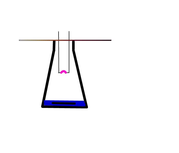

I've got an idea for a simpler setup, just have the arc in a conical flask above a solution of water or dilute nitric acid, then have a little
bubblier setup to dissolve oxygen and nitrogen tetroxide in the water (you could probably even do without a bubblier, if the nitrogen oxide production
is slow. Or use a stir bar).
Something like this:
Something like this: |
Thanks for the compliment. Yes, I came up with that myself. That's not to say that I'm the first person to do it, just that I figured it out in the
lab.
The way the air gap is triggered is not very obvious. One could look at the design, and think that it couldn't possibly work. After all, when the
high voltage gap is broken down (from the ignition coil), why does it also jump the secondary gap (low voltage, high current) instead of shorting out
through the 150V power supply? The reason is, that when the high voltage gap finally breaks down, it does so very suddenly, even explosively. The
voltage rises on the low voltage electrode within nanoseconds. At this rate, the inductance of the lead wires becomes very significant, and blocks the
high voltage long enough to force it across the secondary gap, triggering it.
The high voltage gap distance needs to be adjusted carefully, as the arc must decay completely between each high voltage trigger pulse. If it becomes
a continuous arc, then the secondary gap will not get triggered, as the 150V supply will short out the high voltage discharge. I'll explain all of
this more thoroughly later on.
I think the voltage output is something like 30-50kV. This is an automotive ignition coil (MSD Blaster 2, PN 8202) that is used to fire
spark plugs. The main difference between an automotive system and mine, is that instead of points I'm using a MOSFET (IRF740S), driving the gate with
a function generator. The condenser is placed in the usual location, across the MOSFET's D-S. The supply voltage is about 6V at 2-3A. A complete
automotive electronic ignition system could probably be jury-rigged to give the exact same results.
I don't mind at all if you want to try this yourself. I can't accept prize money for this anyway, so that's not an issue for me. I would certainly
be happy to see someone else interested in this.
Your idea is an interesting one, but may have one difficulty. If the sparking system is placed in a closed flask with water vapors, then the
electrodes, etc., will be exposed continually to nitric acid vapors. Lifetime of the system would probably be short. The outlet of my reactor uses a
copper tube. This is exposed to product gasses right as they come out of the reactor, as well as water vapor from the air. The key thing is that it
takes time for the NO produced to oxidize to NO2, and it takes time for this in turn to react with water. By the time any acid can be
formed, the gasses have already left the reactor, and are in a glass jar.
For the absorption column, I'm thinking of using a 3' glass tube, and packing it full of broken glass. This tube can be laid down on its side, and
filled halfway with water. This way, the gas mixture has to travel the full length of the tube, but doesn't need to bubble through water. Hopefully,
the glass chips will break up any laminar gas flow, and force the NO2 into contact with the water.
