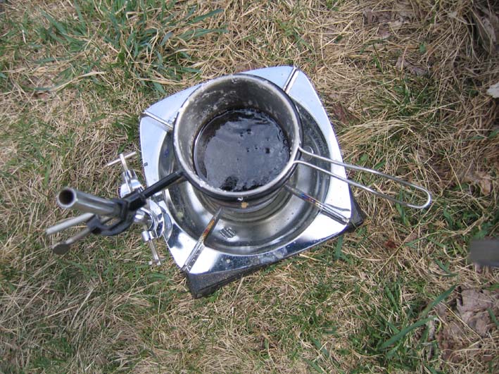

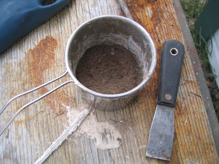

Lead?
I tryed to make aome lead acetate which turned out to be a total failure so I roasted it in a ss cup and it first turned a grey colour and I left it over th flame and it melted again and turned into more of a brown colour WHAT IS IT???
[img]C:\Users\Steve\Desktop\MAY02\New folder\2.jpg[/img]
[img]C:\Users\Steve\Desktop\MAY02\New folder\3.jpg[/img]
[img]C:\Users\Steve\Desktop\MAY02\New folder\1.jpg[/img]
2.jpg - 146kB 3.jpg - 96kB 1.jpg - 44kB
[*] posted on 2-5-2013 at 13:24
What exactly do you call 'failure'? How did you try and make the Pb (II) (OAc)2?
Your end product is likely to be a mixture of substances rather than just one single compound. Try some reactions with it: does itissolve in water or acids to any appreciable degree for instance? Do you observe any effervescence in contact with acids?

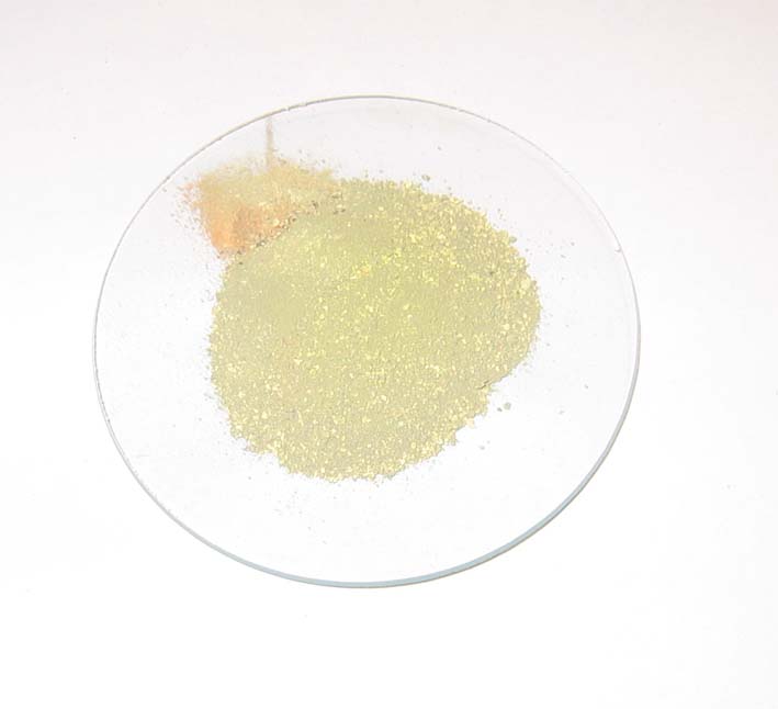

[*] posted on 2-5-2013 at 16:02
I used H202 lead and vinegar. it hardened like a hockey puck when i let it dry. and was a very dark brown.
Any ways as sugested by plant1999 I put it back on the fire and this is the result yellowish green with definite yellow flakes mixed in.
