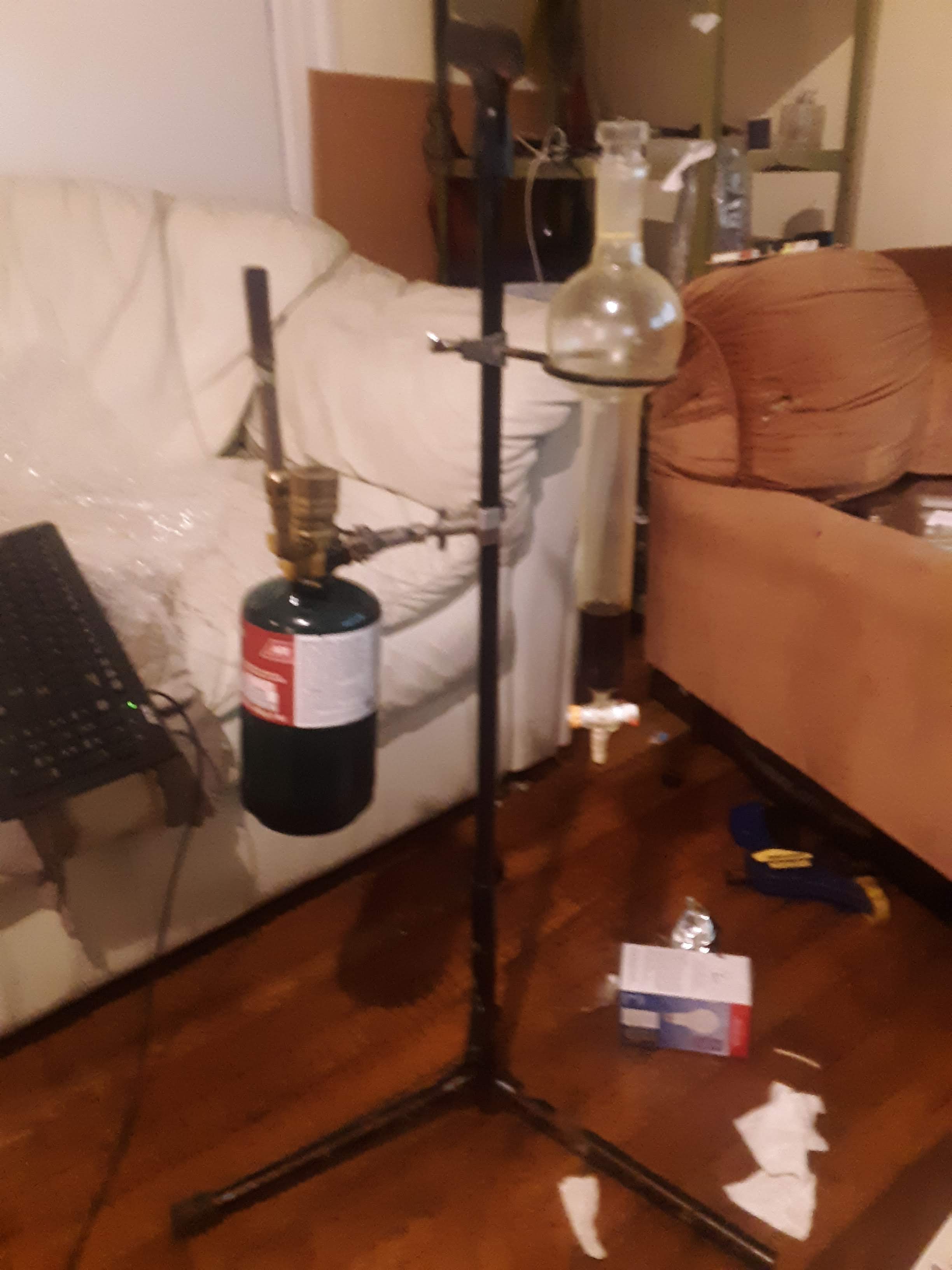

Let's talk lab stands, yeah!
I suppose there are about 5 degrees of repurposing happening here. Just about none of the items are being used for their specific purpose. Y'all wanna guess or should I name them?
:P:P
The second picture of the flask, was one of those, apple falling on the head 'AHA! - I've been torturing myself endlessly, now the problem is solved perfectly. I was too stupid to think of something so simple.
So I have a bunch of stir bars but all of them are the bar shape, made for flat surfaces. Not ONE, has ever, stirred, at least for more then 2 seconds, in ANY of my round flasks. I have owned one tiny pear shaped one for 25ml - 50ml flasks, that's why I even knew it was possible.
I kept telling myself: "Order some special stir bars, don't forget!"
and I kept forgetting.
So I held the example pear shaped tiny one in one hand, and tightly wrapped PTFE tape, over and over, around a big stir bar, until the shape matched. Dropped it in. Observed my first whirlpool in an RBF. Beautiful. Vacuum distillation - like night and say.
20200724_115133.jpg - 328kB
20200724_114912.jpg - 278kB

Music stand..........
Lol, I guess i'll save 'guessing games' for when the bars open up again.
It is a guitar stand, just the lower support arm has been removed. A microphone holder is screwed on to the top. I think maybe it was for a microphone at some point. Now I use it as a very simple but at times helpful 'roller' as in the glass blowing tool. When working a large heavy piece, the glassblower rotates one end, while the other end would be resting on two rolling pins that smoothly turn.
The fancy lab clamp of yesteryear holds the propane torch which is a Turbotorch brand. Bernzomatic copies all of their designs and makes wanna-be imitations. As is, I use it to blow or work glass.
Or, i tightly wrap aluminum foil around the breather holes aka venturri holes aka carburetor vent holes, and it becomes a bunsen burner(like when I tried to distill H2SO4)
Rarely, some torches will have a spring loaded push valve for this purpose. Closed it's like a bic lighter flame. Open and it's the most Oxy to Combustible gas that an ambient oxygen torch can possibly pull, thanks to the high pressure of the venturi effect, in this case on gases.
And that's just a column for chromatography being used like a sep funnel, woopty do =|

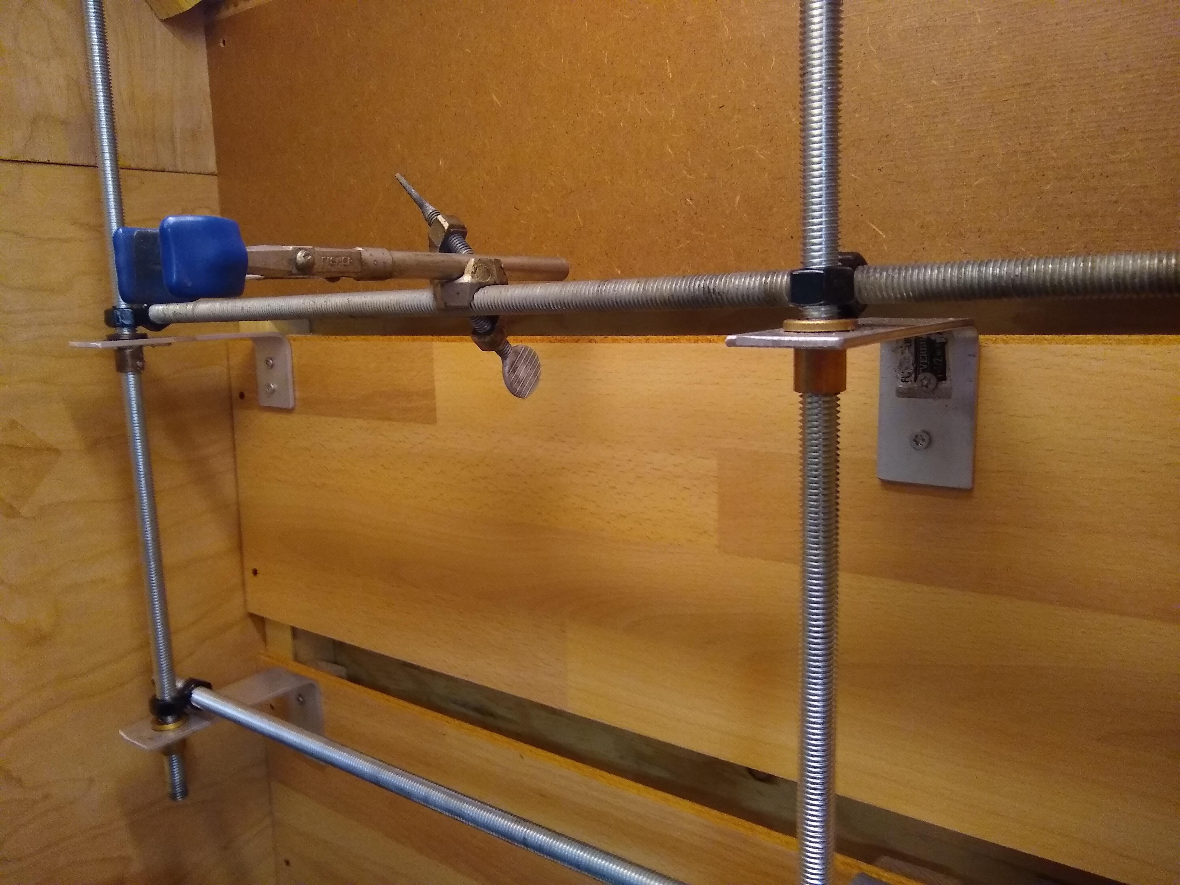

My fume hood racks
Two nuts brazed at right angles with threaded rods mounted to back of hood with right angle standoffs.
IMG_20200707_012646896.jpg - 1.6MBIMG_20200707_012636642.jpg - 1.1MB

OldNubbins: very clever idea; a nice-looking setup. (When I saw this, I wondered why I didn't think of it; lots of things are obvious after you see them!):)

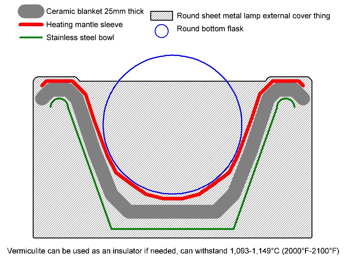

I have decided to make a more complete heating mantle from the heating mantle sleeves i have bought.
They can be used as they are but i would like to build an enclosure so they look a bit more like a real heating mantle.
My plan is to use a stainless steel kitchen bowl, put a thick ceramic insulator blanket (25mm thick) in the bowl and then put my heating mantle sleeve inside this.
Vermiculite can be used as extra insulation if needed, i have a lot of it.
I have found a round sheet metal lamp enclosure that looks very much like a heating mantle outer cover and i will try use this one as the outer cover for the heating mantle.
Something like the picture i have drawn.
Then i could place the DIY heating mantle on top of my hotplate stirrer for the stirring function.
At least until i have figured out how to build the stirring function and the electrical driver.
A modified computer fan could be the start of a stirring function together with som high-temp magnet.
The driver could be a diy triac circuit or a cheap dimmer module from ebay.
It would be nice with a temperature regulating function, maybe a PID regulator with a SSR.
I think i will make a external driver/temp regulator unit so i can use it with different sizes of diy heating mantles.
First i must put together the heating mantle assembly then i can start figure out stirring, driver and temp functions.
Have any of you made something similar?
DIY heating mantle assembly.JPG - 269kB
Nice blueprints!
Remember, the only way to UTFSE for sciencemadness is to use google with special parameter at the end 'site:sciencemadness.org'
without the '
DIY mantles, hotplates and stirrers might be the MOST discussed topic in scimad library that stretches beyond eternity.
Also, lol I have!
I think you're on a good start. The issue of adding stirring whenever you'd like, I actually have a circa 1950's, lab stand clampable, swivel attached,(Edit: The picture in my very next post uses the swivel lab clamp device to hold the digital temperature readout and manage safe wiring suspension in respect to the temp and/or 3-way distillation piece) magnetic stirrer. It (was) driven by an A/C motor with well hidden speed control circuitry, which in turn could be controlled via an in line potentiometer, which was made of incredibly heat-reinforced material. Thomas brand. Anyway, ALL of it's components are currently vital pieces of other monstrosities I have built. I just wanted to re-encourage you that going back as far as the 1950's, even industrially made chem equipment was considerate of having a seperate stirring device to clamp in vicinity to a heating device
I can attest to this as my current set up allows for certain flasks/stirbars to stir very well clamped 6 ot more inches above the surface of the hotplate.stirrer.
So the PID thing: There are some certain users on here that I expect(hope) will chime in here. I agree with the final meta-conclusion made by the explorer Sulaiman:
At the end of the day, precise temperature control inside the vessel is rarely needed. Since:
During any distillation/reflux/evaporation etc. it's the BP of the solvent that determines the temperature, not your PID controller.
Sometimes, like for -serious- fractional distillation, packed column, etc. maintaining a specific temp is really nice.
Then of course there are certain reactions that proceed bellow the boiling point of the solvent. (Most of them, I wouldnt take my eyes off of regardless)
I did read up on the ingenious , outside-the-box theory and history of the PID approach. I love that I stands for Integral and D stands for Derivative, and my favorite part is the analogy of the helmsman.
All that being said, seems like most people here end up just preferring to control the voltage/current/pulse of the heating element instead. Which takes no heed of recorded past data , calculates their integrals, nor does it calculate instantaneous rate of change lol. But some people like the devices that do this via a thermocouple in the hotplate.
Love me or hate me, but I have a few hotplates that i just have an an/off switch for, if that. And I just go by feel. Like a helms man.
i even bought the proper arduino board, gutted an air conditiioners for a daughter board with several solid state relays, pieced together an old Raspberry PI model and started copying python code, but that's on the back burner.
