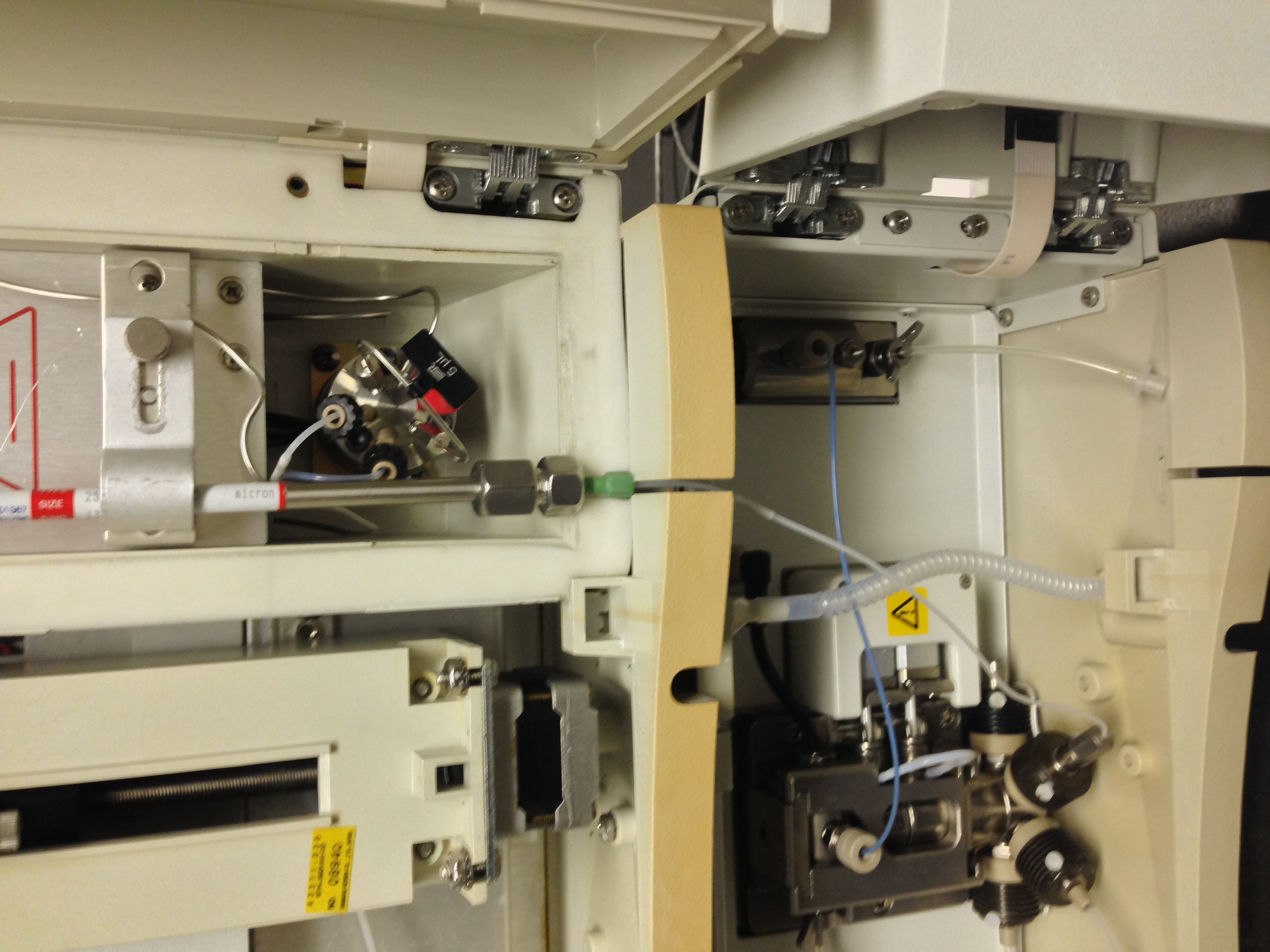

Did I Install This Column Right?
I don't have any instruction manual or anything... Can't find any pictures on the internet of an installed column on this machine (Finnigan Surveyor
HPLC w/ MS Pump).
Thanks.
Kavion123
Posts: 23
Registered: 12-1-2015
Location: Tampa, FL
I know the mobile phase goes through the top and the eluent comes out of the bottom of the column, but I'm just so messed up right now...

It's pretty hard to tell without knowing which way the rheodyne goes. Looks like there's lots of air bubbles in the line though, gonna have to prime
it. Maybe ask a TA or who owns the instrument.

The heating symbol and the door suggests that this is a column oven, so that would be the right place to install it.
However, I am not sure about the connections.
The thing that the bottom of the column is connected to doesn't look like an MS to me, rather like a pump, suggesting the flow would be from bottom to
top.
Yet, the top of the column seems to be connected via a rather long (and thick) tube to a valve with a sample loop, suggesting the flow to be from top
to bottom. Also, however, it looks like the thin tube has just been slid into a thicker tube to connect the two, but such a connection which will
never ever work with typical HPLC pre-column pressures, which is in agreement with the pump being on the bottom.
I would expect the following connections:
Pump to the valve with the sample loop, then to the column (via short and thin tubing), and then out from the column to the MS ion source.
Some columns need to be installed in a specific direction, look if it is marked (arrow, tekst) to indicate this.

But with all the loops they shipped with the machine, only two of them screw into the pump and have another end that screws into the valve. But they
only reach from the pump to the bottom of the column, not to the valve. I looked at the pictures online, and all the machines are stacked this way.
I couldn't locate any arrows or anything on the machine.

The module on the bottom is a quaternary pump. Inside this module you see a metal block, this is the pump itself. Below this block you those 4
'things', which are gradient proportion valves. This is the point at which the tubes which leads to the solvent bottles has to be connected. To avoid
introducing air into the system, make sure you have a solvent on each line. After connecting the solvent lines, prime/purge the system with the purge
valve opened (the wing nut left of the metal block). For about 5 minutes for every channel at 5ml/min.
In your photo, it looks like you've attached the column to the gradient proportion valves, this is not where it belongs.
The tube you connected to the upper side of the column, looks like the waste line to me. You don't want to use this tubing with high pressures, and
even then, the tube is way to thick to get small peaks. As smaerd told you, it is really hard to tell without knowing which way the rheodyne goes. But
it looks like you want the beginning of the column connected to the 'hole' with the red nut inside of it. You can test this just by turning on the
flow and check if the fluid flows out of that port.
The end of the column has to go to the upper module of the system, where the detector is located.
Maybe it is smart to invite someone which is experienced with HPLC to connect everything for you. He can also tell you something about maintenance,
which is crucial for a HPLC system.

Ok so once the solvent reservoirs and serial cable arrive, I'm gonna start the pump and see if any mobile phase comes out of that empty port in the
valve. If it does, I'll connect a loop from that port to the bottom of the column. Then I have to figure out how to connect it to the PDA detector.

I'm sorry I meant tubes, not loops. I'm close to figuring it all out. I'm just missing a tube that lead from the column to the inlet of the PDA
detector, and a tube that leads from the outlet out. I need a tube to connect the pump to the injection valve. But thanks for y'alls help.
