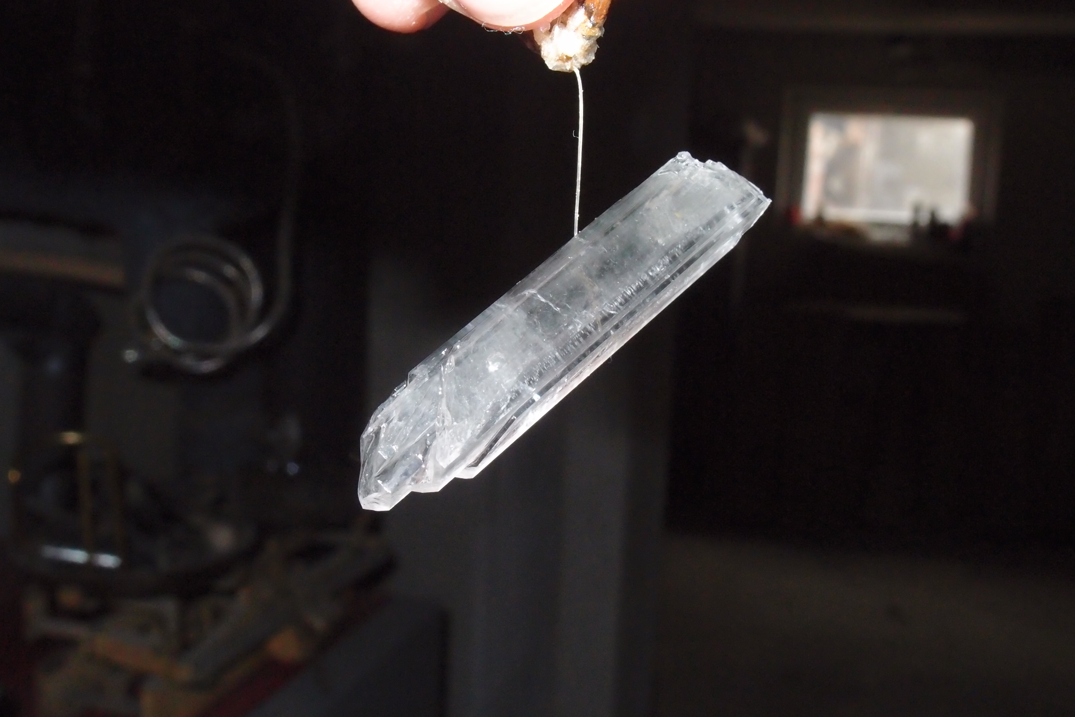

[*] posted on 11-2-2016 at 05:44
Nothing special, but pretty anyway. MgSO4.7H2O monocrystal.
mgso4.JPG - 1.5MBmgso44.JPG - 1.4MB

[*] posted on 11-2-2016 at 07:56
Wow! That's quite a whopper.
Many would be interested knowing how it was made or obtained. I wouldn't usually consider MgSO4.7H2O as an ideal crystal growing material.

[*] posted on 11-2-2016 at 11:08
Epson salt ussually forms long needles and it's difficult to grow large single crystal (it also form many parasitic crystals quite often ) .
That was serious problem for me.
For this crystal I used this procedure:
I made some crystals by slow cooling of the solution.
I picked the pretiest of them and tied it on a thread.
Then I put it back to the solution.
I noticed that the solution is slightly yellow I probably accidentally contamined it with iron(III) chloride (I had worked with it before that). Yeah that seems to be amateur mistake, but it appeared that the iron chloride (which didnt form crystals itself somehow helped the MgSO4 to grow single crystal without any parasites.
Then I let the solution to slowly evaporate.
I don't exactly know how it work :D but I have heard that FeCl3 is sometimes used for similiar purposes.

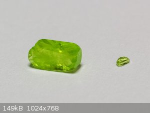

Quote: Originally posted by nezza
This is a small crystal of praseodymium sulphate (About 7-8mm long). It appeared slowly (several months) in a solution of the sulphate I made some time ago.
files.php.jpg - 149kB
Congratulations, Nezza. It's a beauty. Crystallising the rare earth sulphates is not that easy. A bit of luck is needed as well, I guess, as I run into supersaturation most of the times. I have a similar size crystal from Nd2(SO4)3.8H2O. I get the impression that it is an advantage if the solutions are not too pure. My Nd-sulphate crystals formed with ease from the Nd-sulphate extracted from magnets, that surely contained some minor impurities from the magnets.

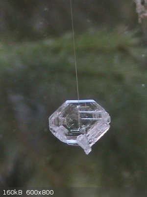

IMG_3314_zoom_cleaned.jpg - 11kB IMG_3150_close_up_cleaned.jpg - 9kB

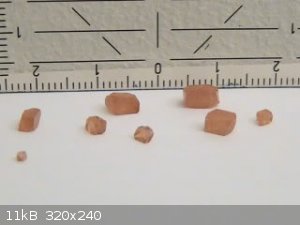

Here's a small samarium acetate crystal. I've seen picture from a German guy who crew crystals a few inches in size from this substance.
IMG_5532_den_adj_detail.jpg - 6kB

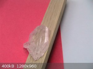

Quote: Originally posted by Dmishin
A similar method worked ... not (NH4)2Cu(SO4)2*6H2O
I wonder why. I tried this in mini-test (few ml of solution), and observed light-blue tabular crystals, clearly different from the pure CuSO4*5H2O.
I got more clusters of crystals than observable single crystals. I'll try again.
Monocrystals should form cubes with some of the corners cut off diagonally, according to H.L Heys' Chemistry Experiments at Home for Boys and Girls (ISBN 9780245554476) . This take very slow evaporation and controlled temperature changes. Mine were crystallised too quickly and gave such results as these.
IMG_4009_adj.jpg - 42kB
