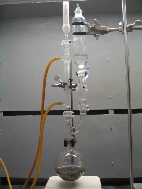

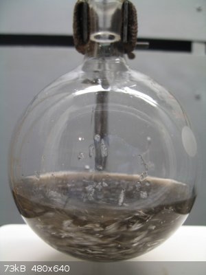

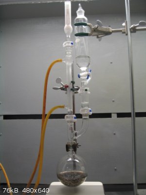

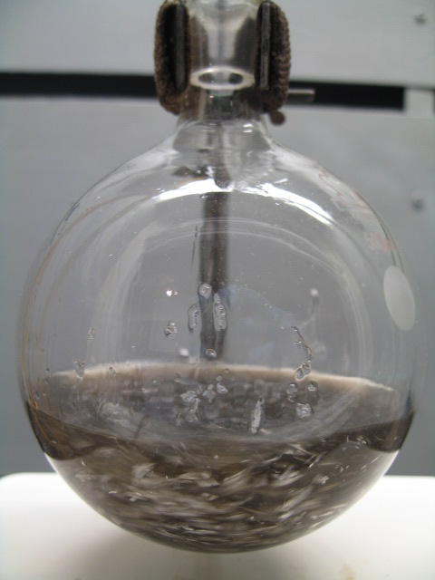

I just finished preparing n-butylMgBr, a Grignard reagent, and wanted to post about the experience as it may prove helpful to some. There are so many threads about this important technology that I couldn't pick one. Hopefully people can express their successes and failures here and get some help if they need it.
ChemPlayer has posted a YouTube video showing that this reaction's fussiness may not live up to its reputation. But when I spend one day making butyl bromide and 3 days getting the bloody ether out of engine starting fluid I take all the precautions to prevent a failure.
For USA ether extractors I find that I like Johnsen's Premium starting fluid (50% ether) the best due to high yield: right at 100ml per 205g can. For Australians I have read that "Start You Bastard" is popular. (Sorry, I couldn't resist that.) I place this over 3A activated mole sieves overnight to dry. I likewise dry my halide that way.
Glassware is dried for ~1 hr at 110°C. This includes every piece that is used for ether and halide transfers.
A CaCl2 guard tube is placed at the top of the reflux condenser.
I keep my Mg turnings in an air tight jar and use them "as is." I obtained these in 2006 from Swany, a forum member as a trade. I've never had a failure using them.
A small piece of iodine (~20mg, I suppose) is added to the Mg turnings.
Today's Preparation
The following procedure is based on the preparation of n-hexyl alcohol found on p. 253 in Vogel's 3rd. I used a 1/3 scale.
A stirring bar (egg) was added to the 500mL RBF followed by 12.2g of Mg turnings. This was set up with a reflux condenser and a 250mL p-e funnel using a Claisen adapter. The RBF was placed in a bowl of warm water over a mag stirrer-hotplate. 53.6 ml of n-butylBr was mixed with 167ml of dried ether and added to the p-e funnel.
The iodine particle was added. Then ~20ml of the bromide/ether solution was added. The reactants were turning dark and I judged the reaction had started so I added 33ml of dried ether on top of the reactants per procedure.
Then the reaction didn't look like it was going so I heated the water bath up to ~45°C. Still no reaction. So I added another 20mL of bromide/ether. Still nothing. Being afraid of a runaway if I added too much reactant I held back. Eventually I began adding more reactant and the reaction then was clearly boiling. I removed the water bath and then added reactant as fast as I could without overwhelming the reflux condenser. Of course the reactants never got very hot as ether boils at 35°C.
Below are pictures of my setup and the product.
Comments, suggestions, and questions are welcomed.
Grignard in progress.jpg - 76kB
n-butylMgBr product mix.jpg - 73kB
finished product

I see you are using a short liebig. I prefer to use a high surface reflux condenser like a Friedrich if you have one. This can handle furious boiling from the ether and still condense it effectively.

If the picture shows finished product then either you have used large excess of Mg or the reaction subsided prematurely.
Looks like the latter.
