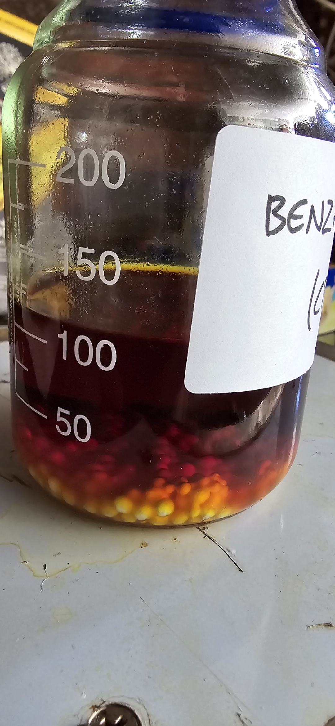

Step 1: Benzyl alcohol route to acetic amhydride
Okay, so far I have done the following:
Prepared a dilute aqueous solution of 78 ml of 70% nitric acid and 520 ml distilled water in a 1000ml round bottom flask. Then prepared a sodium nitrite (5.00g) in distilled water (8 ml) which was poured into the round bottom flask inside a fume cupboard which resulted in minor nitrogen dioxide evolution.
Benzyl alcohol (156 ml, 99.99% food grade) was then added and a liebig condenser attached with ice water flowing and the flask placed in a hot water bath on a hotplate stirrer. Reflux was performed at approximately 90°C (water bath 95°C allowing for difference in thermal transfer between bath and flask wall) for 4 hours before cooling to room temperature.
After cooling, the crude benzaldehyde was collected using a seperatory funnel. The benzaldehyde was washed twice with 200ml saturated sodium bicarbonate solution to neutralise residual acid which also resulted in small spillage when the stopper was not on properly during venting. There is a fair quantity of gas evolved so very frequent venting is required for the first wash.
The crude benzaldehyde was then washed with 200 ml saturated sodium chloride solution before being placed in a reagent bottle with anhydrous calcium chloride in the bottom to thoroughly dry the product before a vacuum distillation can be performed. The crude product is very red in colour as can be seen in attached image.Step 1:
This should then be able to be reacted into benzoyl chloride, then acteyl chloride and finally acetic anhydride if all goes well.
