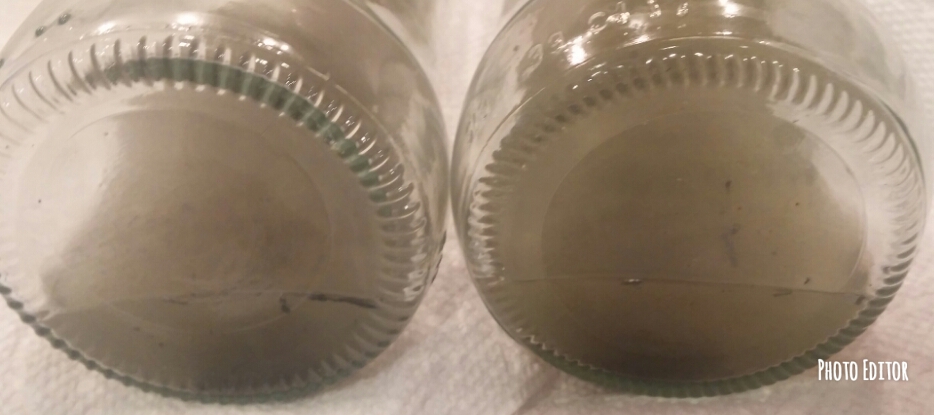

I conducted an interesting dual experiment by add 10 grams of citric acid crystals and 120 ml of 3% hydrogen peroxide (normally acidified to stabilize) to the metals of aluminum (flamed treated, see discussion at http://www.sciencemadness.org/talk/viewthread.php?tid=94166#...), a very small amount of iron filings and some sea salt in two vessels in a microwave for 1 minute. The two reaction mixes where then simultaneously subjected to a cooldown period of 30 minutes in a freezer. This was followed by aeration from an air pump, but in only one solution (I select the mix that appeared a little darker) for one hour. At the end of the hour a picture was taken and the air hose placed in the other vessel for the same treatment time. The goal of the experiment would be to see if there is a visible difference in the appearance of the solution as a joint consequence of aeration and the presence of Al3+ at various stages of the experiment.
RESULTS
Clearly the use of aeration accelerated miscellaneous reactions. This may be due to either largely from the recycle associated with O2/Citrate acid (as detailed above), or largely assisted by Al3+ complex formation leading to more ferrous creation, or neither is discernibly more influential. However, a close examination of the pictures notes that all Al was eventually consumed, but this was not the case one hour before termination of the experiment as there was visible Al in the first aerated solution, which apparently dissolved without the help of O2 (or the Al3+) in the last hour. But, during the last hour, the starting Al3+ conc was likely higher for solution 2 than for when the 1st solution that was aerated an hour earlier, which implies the observed equal or darker coloration achieved for Solution 2 could be due to the higher average Al3+ concentration perhaps by way of a more significantly powerful aluminum complex formation.

Why the solutions look muddy?
AJKOER
Posts: 2927
Registered: 7-5-2011
[*] posted on 7-10-2018 at 10:51
Good observation!
There is the usual residual black residue from store brand Al foil (SiO2 perhaps).
Also, as I mentioned in the opening thread, some chemistry suggests a basic salt formation, and many such basic salts are not soluble as the solutions pH increases.
Interestingly, I noticed the viscosity of both solution appears a little elevated (guess is clear Al(OH)3 not dissolved by Citric acid) so particles may not be settling down quickly after being jarred.
I am also planning on posting a smarter picture after some time following settlement.

The muddy appearance may also be due to the presence of carbon in the Al-foil. I also noticed this effect in many experiments with Al-foil, also in experiments with acids.
I also have very pure Al (99.99+ % in the form of small needle-like pieces) and when this is used in experiments with acids I get clear solutions.

Thanks for the comment as apparently having very noble carbon forming a large surface area cathodic zone is a very good thing when the goal is to put the Al into solution. Here is a quote from a reference (see https://www.corrosionpedia.com/galvanic-corrosion-of-metals-...):
"The carbon fibers are electrically conductive and electrochemically very noble. Therefore, when a metal is electrically connected to a CFRP, it is more susceptible to galvanic corrosion. This situation becomes worse when a large surface area of carbon composite components is coupled to small metallic parts (such as fasteners, bolts and nuts). In these circumstances, the rate of galvanic corrosion is extremely high due to the high cathode to anode surface area ratio (Ac/Aa).....
Aluminum alloys are extremely vulnerable when they are coupled to a carbon composite"

Final pictures where the small amount of white salt is thought to be ferrous citrate and the green tinted solution is likely ferric citrate as pH is above 2 (see https://en.wikipedia.org/wiki/Iron(III)_citrate ).
Neutralization of both solutions with sodium bicarbonate maintain some green tint and suspected to be ferrous bicarbonate. A large amount of white precipitate also created, could be prior created insoluble ferrous citrate, basic aluminum citrate, basic aluminum carbonate, and/or aluminum hydroxide.
