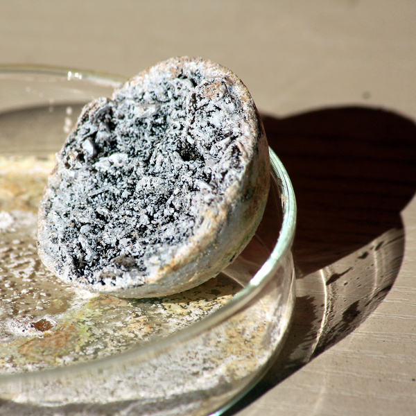

after almost 10h operation, the fork was only superficially corroded (at the teeth). meanwhile, a stratified sediment formed, which was removed after cooling:
layers.jpg - 173kB

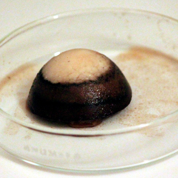

the tip is undissolved soda. i think the layers are due to fluctuations in throughput due to the solution shrinking below the anode level, and later being filled up.
after the convex side dried up, the mass was turned over. the flat side was covered in brown/purple crystals, like a geode. unfortunately i wasn't able to capture the crystalline look, as the residual soda solution quickly dried and covered it in white too:
geode.jpg - 176kB
sadly this was the most interesting part of the experiment. the leftover electrolyte has almost completely solidified, the filtrate looks a rusty brown. i'll try to verify if there's any chromate in there.
edit. no appreciable change with thiosulfate.
[Edited on 16-10-2012 by tetrahedron]

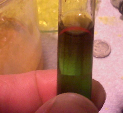

after putting a few ml of con H2SO4 in a testtube, I added a few drops of sodium dichromate. my straw color ACE hardware acid turned a smokey red, and yet clear top layer. 1/8" thick. but when I cam back to it a while later I found a bright red opaque line on the side of the tube at solution line. it was bright red and kinda looked like tiny particles of sand. got a pic but not time to put it up. it was a very verry small amount. but clearly visible. and unlike any other sulfate or chromate/dichromate I have seen to this point. so I believe it was indeed chromic anhydride. I tried to fish some out to try a drop of MeOH on it(saw youtube vid w/ CrO3-EtOH = flames). I could feel it crunching as I tried to get it out. but most stuck to the testube wall.
it seems to be produced and if shaken dissolves again. I noticed this bright opaque lipstick colored ppt on initial addition of the dichromate sol. but shook it and turned into a red/rootbeer colored band. may be tiny dispersed crystals. I retried and got the above results. with the red line by not disturbing it.
also from one of my last attempts to ppt the dichromate pissed me off, so I returned it to chromate boiled down(in prep to oxidize again) a bit and left stand for a day while trying to figure it out. came back to BIG LONG bright yellow crystals. sever were 3" long and roughly 2/3 the diameter of a standard pencil. I broke one open see if it was just sodium sulfate coated with a vibrant chromate... but no it was yellow all the way through. I know I had a lot of Na2SO4 in there, but it seems to have formed another complex with the chrome ions. again I have pictures but will have to wait till later today to retrieve them from my phone resize and post.
doesn't seem like it would be feasible to do for small scale with a decent return, and with large scale you have a LOT of hexavalent Cr and con. H2SO4 laying around... but was worth a try. would like to see some large CrO3 some day.

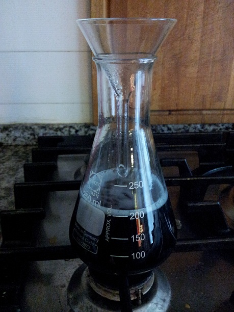

20121017_143458.jpg - 76kB 20121017_154328.jpg - 122kB

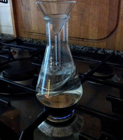

[*] posted on 18-10-2012 at 11:52

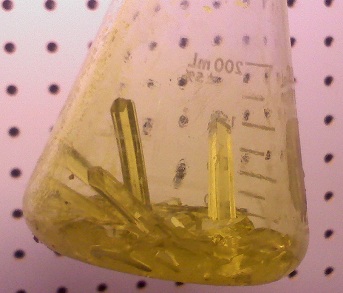

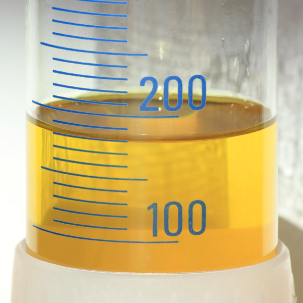

yesterday i took some of the sludge that i got when "electrodissolving" stainless steel in a Cl- containing electrolyte and poured it into a fresh solution of NaOH and NaCl (about 1 spoonful each in 400ml tap water), which i then electrolyzed for a couple hours with a 5mm diameter graphite "gouging rod" anode, initially @ ~7V, soon reduced to 4.4V & 3A in order to reduce the loss of chlorine. i noticed a faint chlorine smell during the procedure (it was done outside), as well as after unplugging the current. even after standing overnight i still noticed some bubbling, which i can't explain.
the chloride only acts as a catalyst, first converting at the anode into chlorine and immediately afterwards to hypochlorite, which oxidizes Cr(III) to Cr(VI), reverting to chloride.
the filtrate looks promising
electrss.jpg - 109kB
although i still don't have a way to quantitate the chromate present, and i can't tell how much chromite is contributing to the color.
[Edited on 18-10-2012 by tetrahedron]

hey here are the pictures I meant to post :)
red chromic anhydride from the warm dichromate dropped into concentrated H2SO4. the tube was laid to rest for a while tipped a bit and made the opaque crystals.(lill red upside down smile)

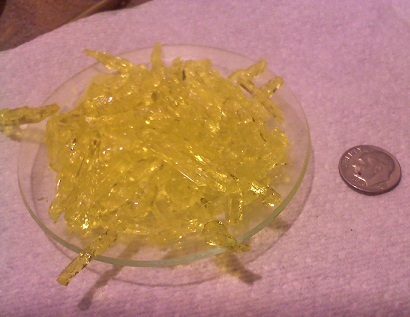

here are the large crystals that grew over a day or so when I got mad about the Na sulfate contamination. not too bad for growing that quick in a 200ml flask. still not 100% sure what the composition is though.
big crystals 1.jpg - 33kB
here is most the pile in a watch glass next to a dime for size comparison.
pile of crystals.jpg - 50kB
sorry the pic's aren't the best only off my phone. but *seems* that the chromic anhydride description from the reference book worked just fine.

Hey violet wonderful crystals ! I think they could be pure
[*] posted on 20-10-2012 at 06:32
Wonderful crystals indeed, but what are they? The solubilities at 20 C (Wiki solubility table) of sodium chromate and sodium sulphate are respectively 84 and 19.5 g/100 ml. If sodium sulphate is present in appreciable quantities it could well crystallise out first.
You really need to take some of your crystals, crush them up and dissolve them in a minimum of hot water, then allowed to crystallise again and see what they look like…

I then simmered the slurry for a bit and allowed it then to stand and cool. Below is a photo of it after about 15 minutes of standing:
The supernatant liquid clearly shows there is chromate in solution (although at that pH perhaps chromate/dichromate in equilibrium) but there is also a considerable amount of an unexplained brown, heavy (it sinks pretty fast) precipitate. Note that bad lighting shows the liquid far darker than it is to the naked eye. It's really strong yellow.
The fairly low pH at the end is of course a bit worrying: did oxidation stop because of lack of alkalinity? How then to explain the brown precipitate?
Tomorrow the supernatant liquid will be decanted off and some test tube tests will be done on the precipitate.
[Edited on 21-10-2012 by blogfast25]
