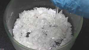

Silver nitrate
| Dry silver nitrate crystals
