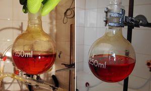

| Photo by sciencemadness user len1

| Appearance | Red fuming liquid |

It is a bright red liquid with viscosity similar to water.
