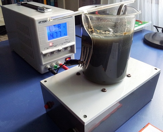

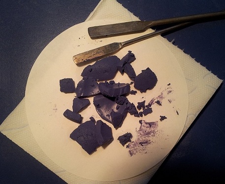

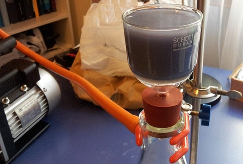

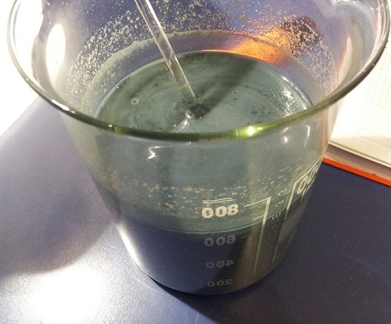

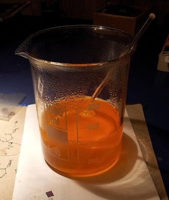

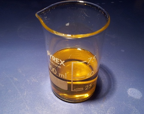

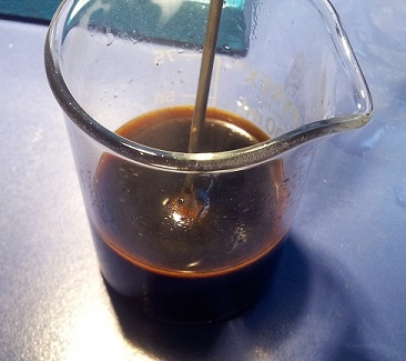

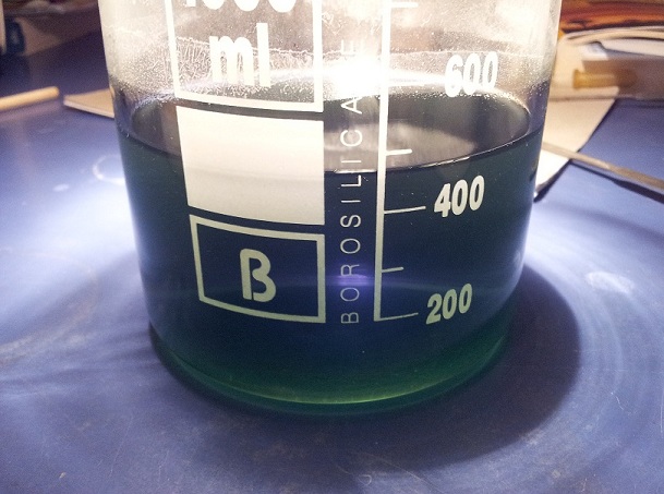

Ok finally I did it!
I told you that I would have posted my procedure and the photos so here I am.
I started from 18/10 stainless steel from a fork, I electrolyzed it in a 25% NaCl solution with my lab power supply adding some 33% HCl to destroy the hydroxides formed. than I stopped it after 2 hours and I filtered the solution to obtain a clear green solution.
Than I added a saturated Na2CO3 solution to precipitate iron/nickel and chromium as hydroxides, I didn't use a NaOH solution because strong sodium hydroxide solutions react with chromium hydroxide to form soluble [Cr(OH)6]3-.
Anyway after the precipitation I filtered the solution and I obtained a dark green/brown sludge that I washed with water. Than heating the sludge, I added a really strong NaOH solution to it,and than 35% H2O2, 10ml a time, to oxidize Na3[Cr(OH)6] to sodium chromate, so the sludge after lot of fizzing, turned brown and I filtered it obtaining a yellow sodium chromate solution.
So because I wanted to remove the excess of NaOH, NaCl and everything else I added HCl to the sodium chromate solution until acid, I reduced it adding hydrogen peroxide again and I precipitated Cr(OH)3 adding sodium carbonate.
I washed my chromium hydroxide with hot water many times and I obtained a blue mass that I redissolved with as little as I could of a strong NaOH solution than I added the right amount of H2O2 and I heated the solution, after filtering I got a really strong yellow sodium chromate solution.
Now I checked the pH of the solution and it is high so I have some sodium hydroxide in it, do you know how can I remove it for the last time?? I thought to sulfuric acid until pH 7 maybe sodium sulfate is easy to remove.. I dont know
Damn I want an induction heater and damn believe me filtering hydroxides or oxides is time consuming and a pain in the ass.

[*] posted on 13-10-2012 at 12:14
Well done, Salmo.
Two comments:
[snip]
Your reasoning is correct but chromite [Cr(OH)4(-)] does not appear to form when large amounts of iron are also present (as is the case here). In those circumstances, the Cr3+ appears to co-precipitate fully with the iron oxide(s). But as you’ve seen later on, Cr(OH)3 on its own does dissolve in strong NaOH to form sodium chromite.
Re. removing the remaining peroxide. DO NOT acidify at this point because in acidic conditions the excess peroxide will reduce the chromate back to Cr (III)! The best way of destroying left over hydrogen peroxide is to simmer your solution for some time. Then take attest tube sample and acidify it. It should revert to the yellow/amber of dichromate. If any blue/green appears, you’ve still got peroxide left.
Re. removing the excess NaOH. For dichromates usually the K salt is preferred, I believe because K2Cr2O7 is only sparingly soluble in cold water and thus easier to isolate. The excess KOH would be neutralised with H2SO4 and on cooling crystals of K2Cr2O7 would appear, provided you started from about the right amounts of KOH and Cr. I’m not sure how this will pan out with Na2Cr2O7.
Nice photos!
[Edited on 13-10-2012 by blogfast25]
