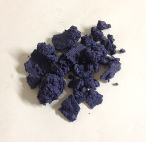

Chromium(III) sulfate most often appears as a blue-grey or violet-grey amorphous solid. Recently prepared samples or those that have been subjected to heat may contain a deep green-colored sulfato complex and are hygroscopic as a result. Purer samples can be dried to form a lighter-colored powder.
Chromium(III) sulfate is readily soluble in water and some lower alcohols.
