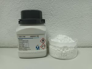

Potassium iodate sample and original bottle
